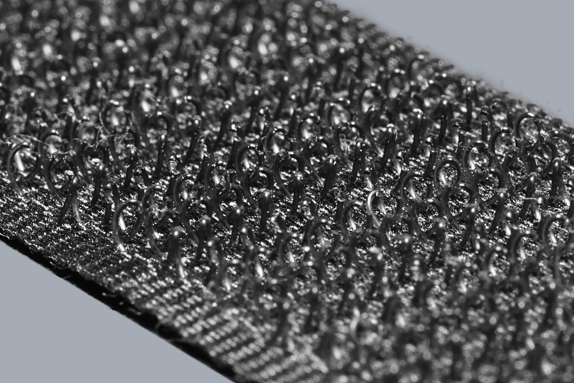

Can you please upload a picture of what you exactly want to create?
I will try to create something like this.

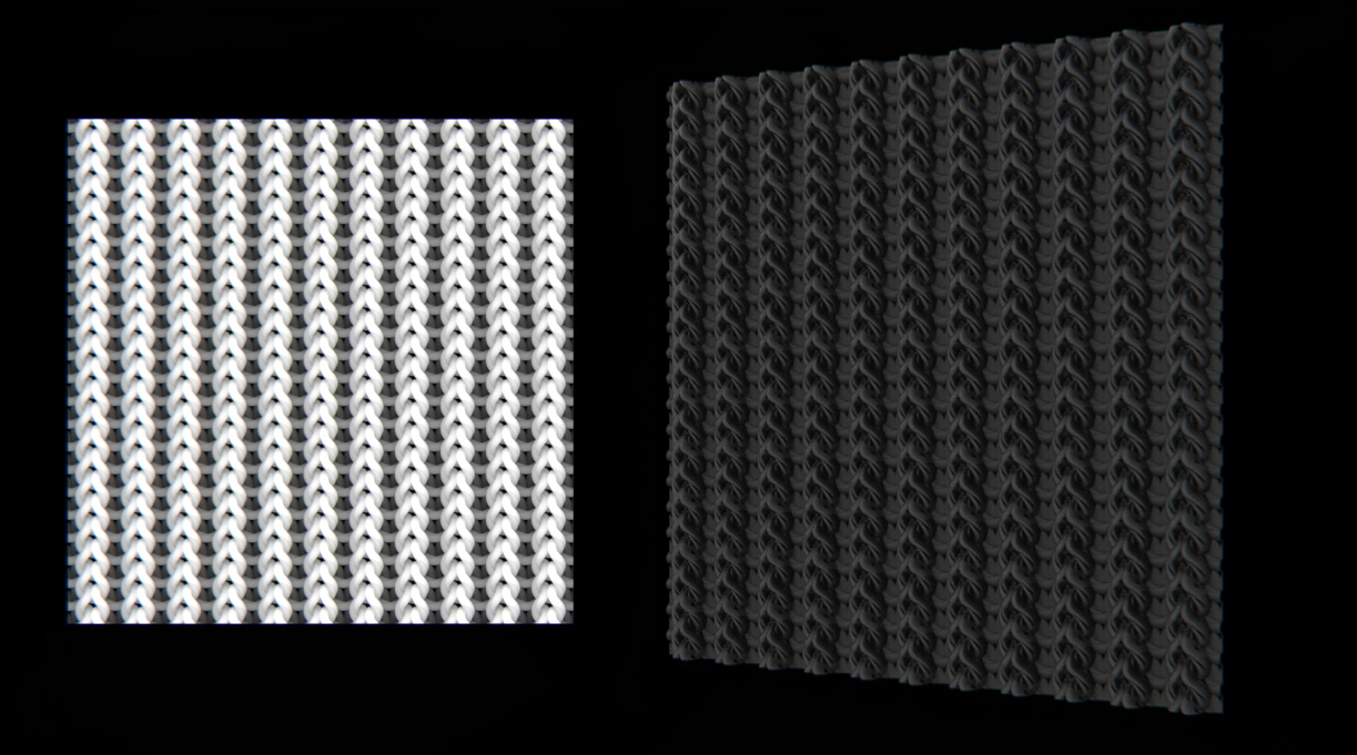

I was thinking about creating many hooks in 3D and bake a displacement map from those which you can use in Keyshot. Maybe you need to trick the scale of the scene a bit to have it work out well since those hooks are so tiny and the render engine needs some ‘space/surface’ to work with as well.

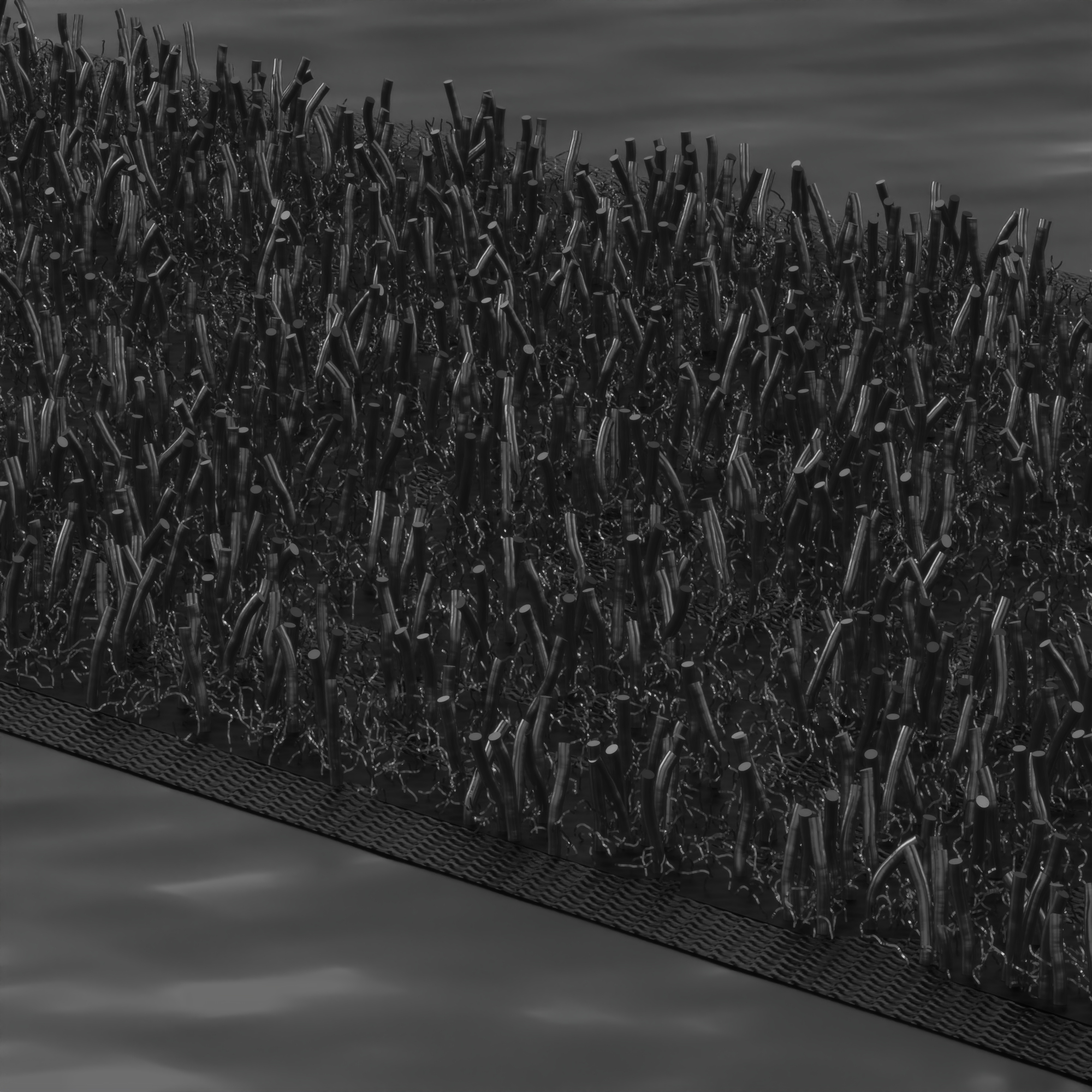

Gave a try and got this result.

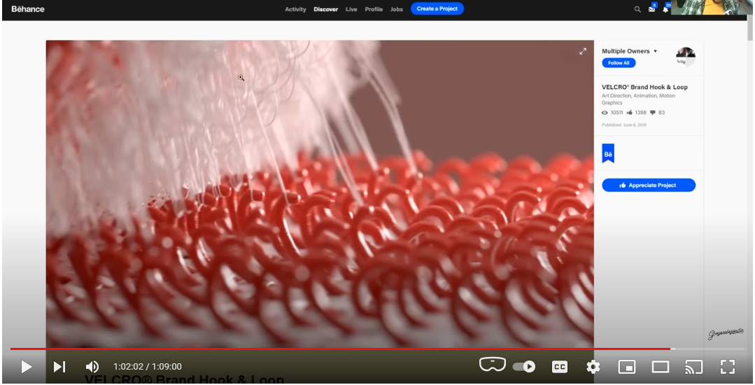

Velcro is pretty fascinating, that displacement wouldn’t really work I found out. Did came across this clip which is really modelled the way it works. Thought it looks cool. If you watch for a little bit you also see a slomo of the real material which gives a nice look on how it works.
Recreating the Velcro Effect In Cinema 4D | Greyscalegorilla AskGSG - YouTube

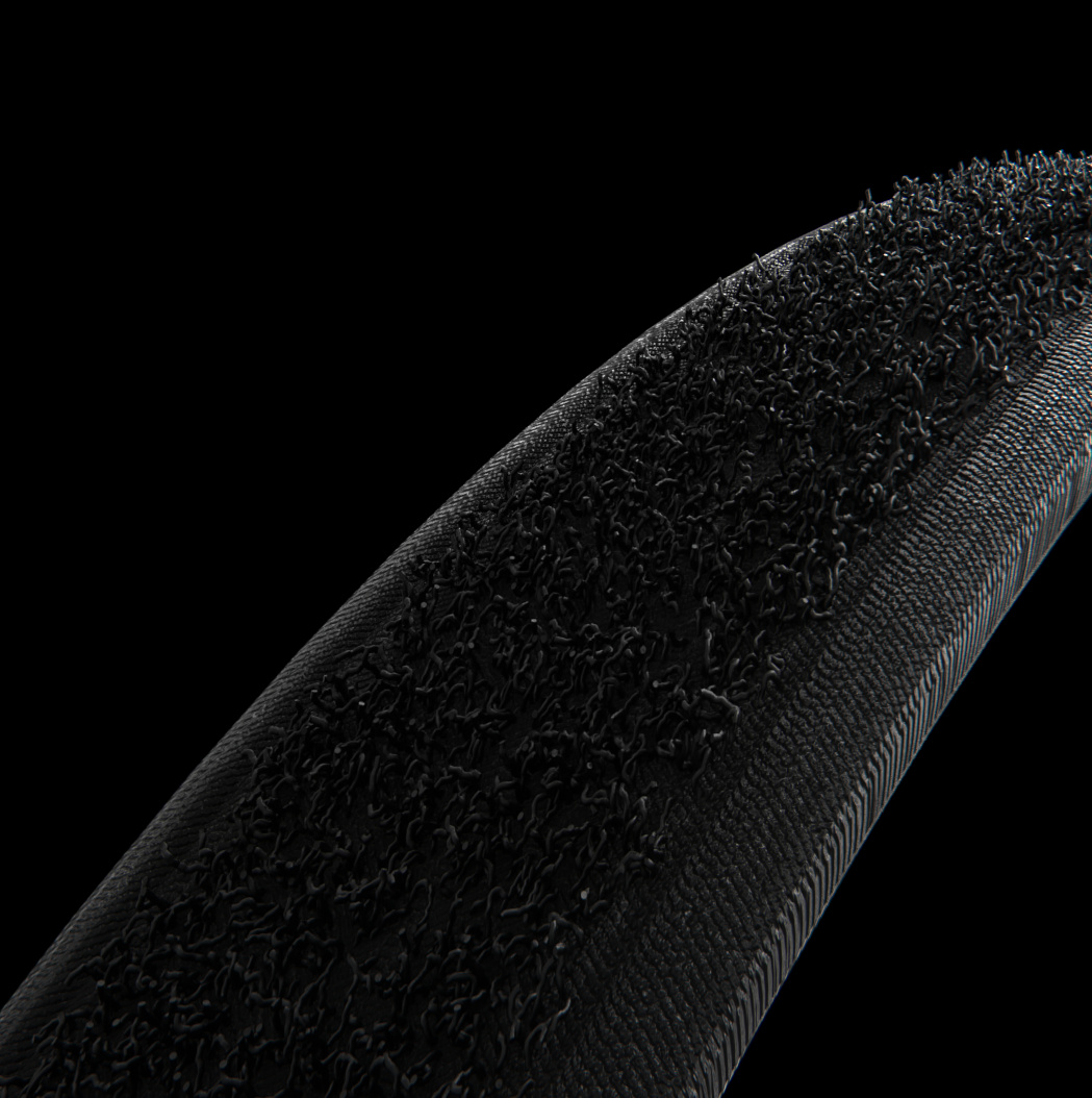

Check this out, I am also trying to create this. To some extent it is successful.

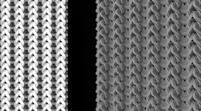

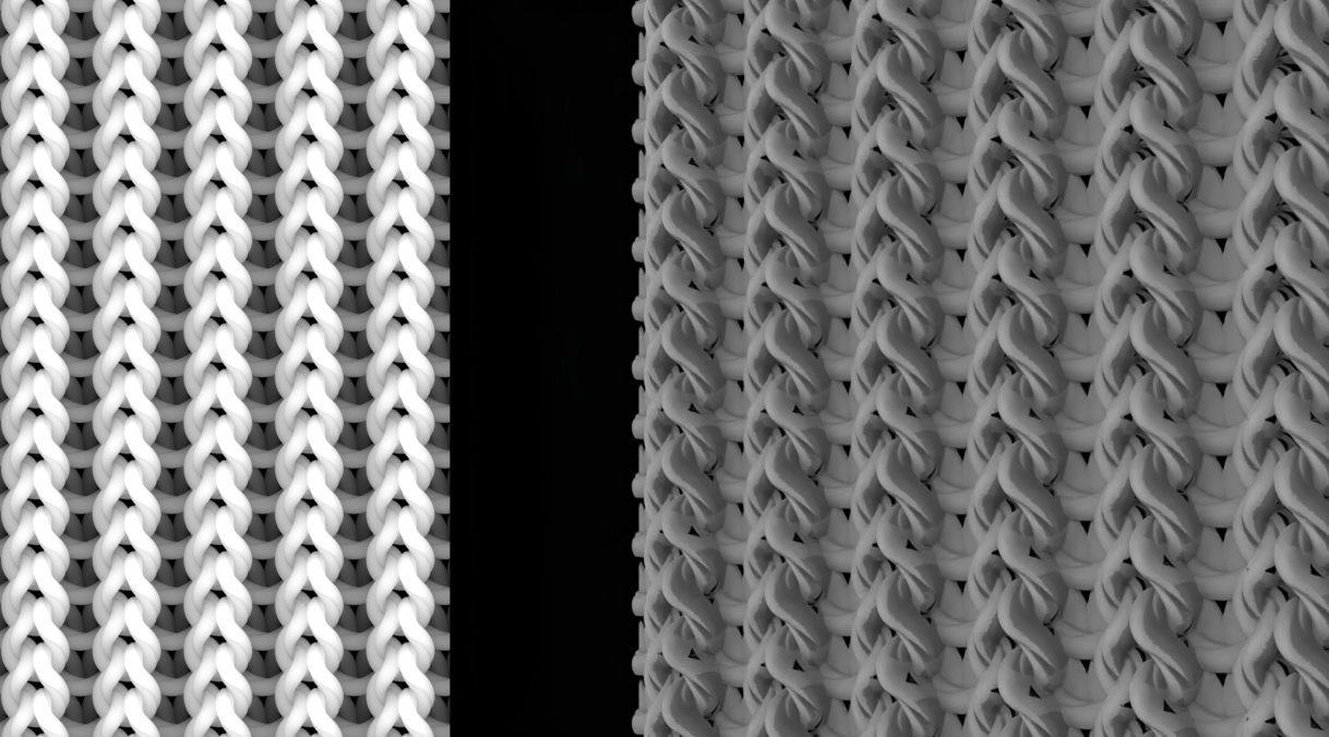

If you want to show this very closely, create this as a brush in Zbrush and then create an Alpha map for us. It can be used in Keyshot.
Sample :
